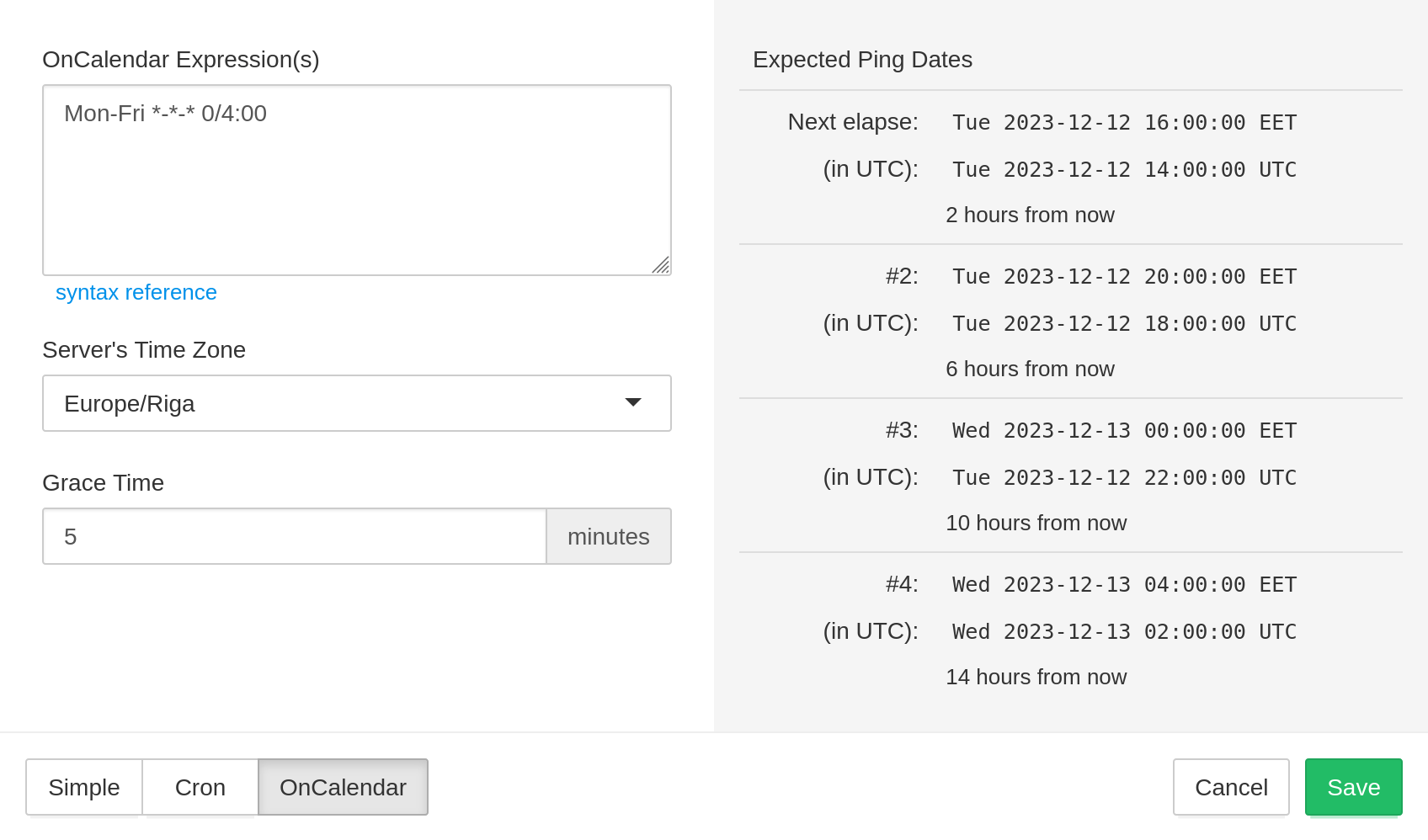

OnCalendar Schedules
Inside the .timer file, the task's schedule is set using the OnCalendar option which takes a calendar event expression:
[Unit]
Description=Run copy-media.service every 4 hours on workdays
[Timer]
OnCalendar=Mon-Fri *-*-* 0/4:00
[Install]
WantedBy=timers.target
The calendar event expressions are different from cron expressions. SeaTable Healthchecks supports them natively–you can specify a check's schedule using the same expression you use in the .timer file:
Editing OnCalendar schedule
Read more about calendar event expressions in Systemd docs.
