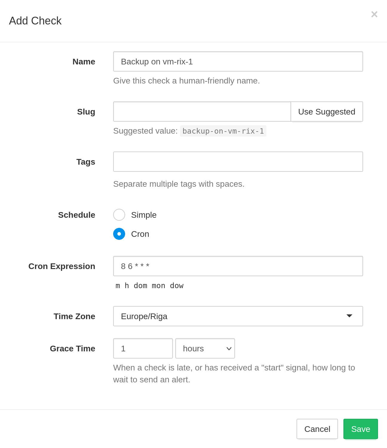

To monitor it, first create a new Check in your SeaTable Healthchecks account:
The "Add Check" dialog

Grace Time
Grace Time is the amount of extra time to wait when a cron job is running late before declaring it as down. Set Grace Time to be above the expected duration of your cron job.
For example, let's say the cron job starts at 14:00 every day and takes between 15 and 25 minutes to complete. The grace time is set to 30 minutes. In this scenario, SeaTable Healthchecks will expect a ping to arrive at 14:00 but will not send any alerts yet. If there is no ping by 14:30, it will declare the job failed and send alerts.

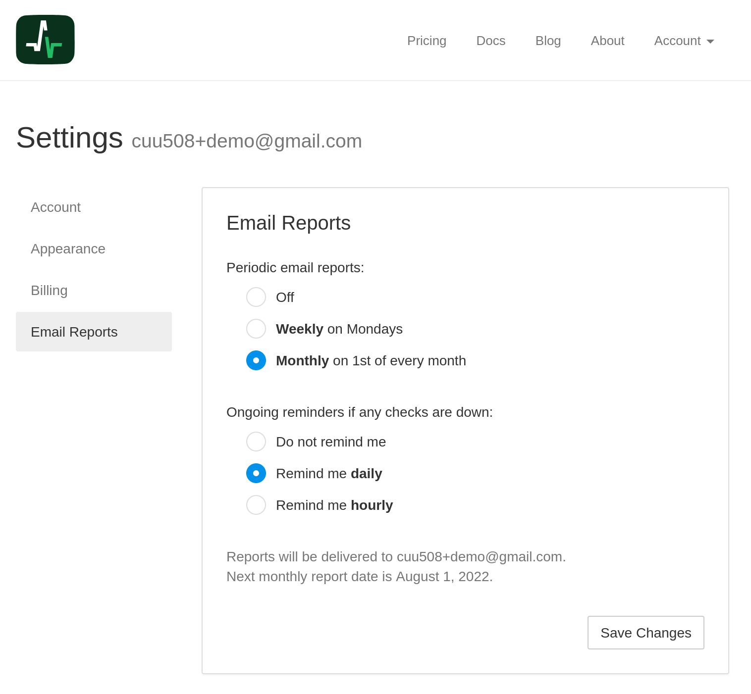

Additionally, to make sure no issues "slip through the cracks", in the Account Settings › Email Reports page you can configure SeaTable Healthchecks to send repeated email notifications every hour or every day as long as any of the jobs is down:
Email reminder options
