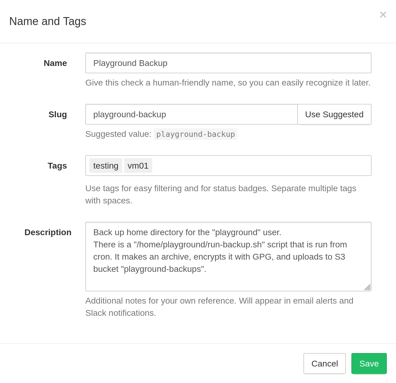

Name, Tags, Description
Describe each check using an optional name, slug, tags, and description fields.
Editing name, tags and description
  • Name: names are optional, but setting them is a good idea. Good naming becomes especially important as you add more checks to the account. SeaTable Healthchecks will display check names in the web interface, email reports, and notifications.
  • Slug: URL-friendly identifier used in slug-based ping URLs (an alternative to the default UUID-based ping URLs). The slug should only contain the following characters: a-z, 0-9, hyphens, and underscores. If you don't plan to use slug-based ping URLs, you can leave the slug field empty.
  • Tags: a space-separated list of optional labels. Use tags to organize and group checks within a project. You can tag checks by the environment (prod, staging, dev, etc.), by role (www, db, worker, etc.), or by using any other system.
  • Description: a free-form text field with any related information for your team or your future self. Describe the cron job's role, who set it up, what to do in case of failures, and where to look for additional information.

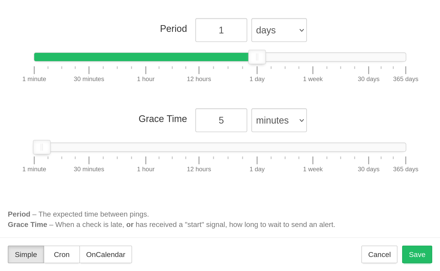

Editing the period and grace time
For the simple schedules, you can configure two parameters, Period and Grace Time.
  • Period is the expected time between pings.
  • Grace Time is the additional time to wait before sending an alert when a check is late. Use this parameter to account for minor, expected deviations in job execution times.
Note: if you use the "start" signal to measure job run times, then Grace Time also specifies the maximum allowed time gap between "start" and "success" signals. Whenever SeaTable Healthchecks receives a "start" signal, it expects a subsequent "success" signal within Grace Time. If the success signal does not arrive within the configured Grace Time, SeaTable Healthchecks will mark the check as failed and send out alerts.

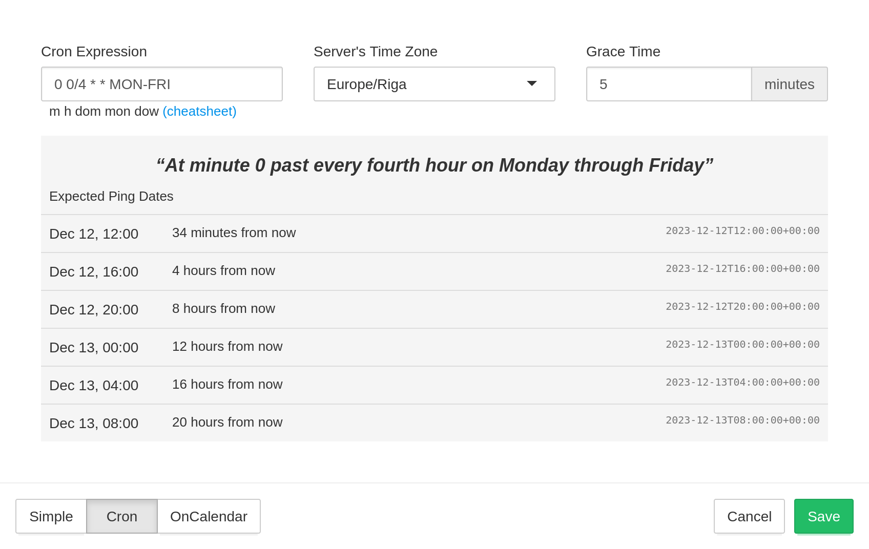

Cron Schedules
Use "Cron" for monitoring cron jobs and other processes with more complex schedules. This monitoring mode ensures that jobs run at the correct time and not just at the correct time intervals.
See Cron syntax cheatsheet for cron expression syntax examples. See crontab(5) man page for complete cron syntax reference.
Editing cron schedule
You will need to specify Cron Expression, Server's Time Zone, and Grace Time.
  • Cron Expression is the cron expression you specified in the crontab.
  • Server's Time Zone is the timezone of your server. The cron daemon typically uses the system's local time. If the machine does not use the UTC timezone, specify its timezone here.
  • Grace Time, same as for simple schedules, is how long to wait before sending an alert for a late check.
